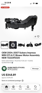

Looking for Internal Heater A/C Blower Fan Motor.

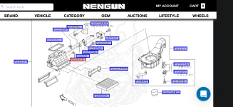

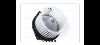

What would be the exact part number and can motor/fan be got separate to the entire housing body.
Any one buy one recently?
For Subaru Impreza New Age.

Give Ali your chassis number and he’ll look it up ,
It will be available separately from the housing , is it definitely gone ?

Has power. Kicks on eventually gets going with a little push.
Brushes are nearly gone in motor.
Also seems to be a complete sealed unit.
Plastic and motor.
