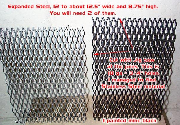

- Some expanded Steel or Expanded Stainless Steel if you can get it. I found only expanded steel at my local hardware store. Enough to make 2, 12 - 12.5" wide by 8.75" high pieces. I found 18 ga with 3/4" openings worked the best. You can cut the material with a jig saw, if you have access to a metal shear even better. Cut at the joins and file the ends smooth a Dremel worked for me.
