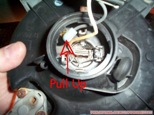

With the foglamp unbolted, it will almost fall right out of the opening. There is a large gray cap on the back- simply turn this counter-clockwise to open and to access the bulb connectors. You will find one wire running to a brass terminal on the outermost portion of the inside ring of the foglamp. Pull this up towards you and disconnect it. |
