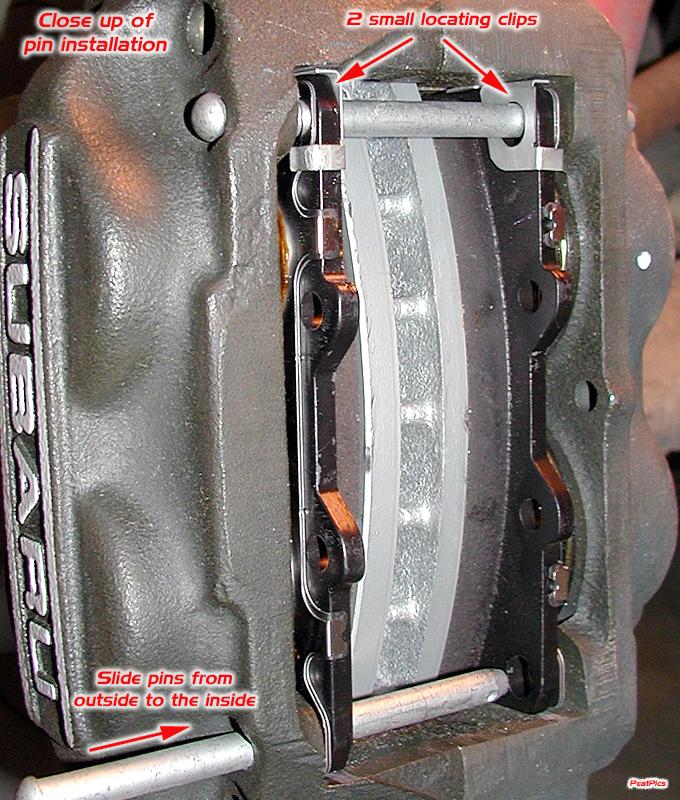

Now put the 4-pot caliper in place. Be sure to place the caliper with the bleeder valve on the top and not the bottom. If you don't you will not be able to properly bleed the brakes. Air will get trapped. The 2 /17 mm bolts that hold the caliper on should be torqued to 51-65 ft/lbs. Now prepare the brake pads for installation into the caliper. There are 4 pads. Two of them have wear indicators on them and two don't. (see pics below) Make sure each caliper gets a pad with the indicator. The pads appear the same other than the indicator; I don't think it matters if it goes to the inside or outside of the rotor. Find that copper colored packet and cut a corner of the plastic. This is the anti-squeal compound. Put some on the back of each pad, then put the vented shim, more compound, the solid shim and a little more compound. On the top of each pad, fit one of what I call "locating clips". Those small gray metal things. You should have 4 of them one goes on the top of each pad (see pics) Slide the assembled pad in the top of the caliper. Push it in till the holes in the pads line up with the holes in the caliper. The two holding pins will come through the holes and secure both pads . Watch the position of the top locating clip, it's a pain to get in properly. Now put the long holding pins in from the outside of the caliper to the inside. If the shims didn't move this will go smoothly. If they have shifted it's a pain. After the pins are in, take the long wire, with the bent ends and hook in the center, and put the ends of the wire though the holes in the pin ends. Then put the hook in the hole in the caliper. See pics below to get a better understanding of this. Next install the anti-rattle clip. The small end hook goes under the top pin and the long loop clips over the bottom pin. Again look at the pics. |

Pins |
Pin locking spring |
