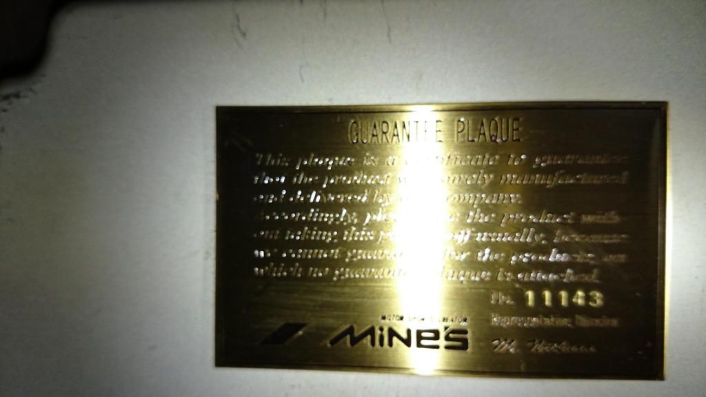

Just noticed a Mines ECU in my car, anyone have experience with these
Hi Gordon, I was talking to James in Couture Auto today on the phone. Aonghus used to do his mapping there before he moved to Galway. James rang him for me today asking if the Mines mapped ECU in it can be overmapped, He said he wouldn't be able to map it once it has the Mines mapped ECU in it already even though Bob Rawle emailed me saying he would be able using Ecutek, which I know is going to work out very expensive.
So my other option is to get a standard B4 ECU from a breakers & get Aonghus or Joe Power to map it for me to suit Irish Fuel
Cheers Danny, I had rang James in Couture Auto earlier today ( He is a customer of mine) before i was speaking to you to see if he could identify the power cut / loss of boost over the phone. He didnt answer but rang me back around 7pm and he told me it could just be the Mines Map is too agressive and he would recommend putting a standard ECU into it. I checked the vacum hoses and they all seem ok, nothing looks like it popped off so Id say myself its just the fact that I put Esso & then Topaz unleaded into it. Cheers for the offer of a standard ECU, I might drop down to you one of the days, Ill see how it fares out over next few days, having just put Octane Booster into it this evening & going to fill it with Maxol E5 tomorrow too.
