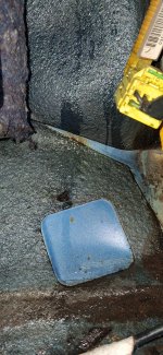

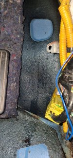

Went to get the ra ready for west cork and noticed the driver's carpet soaking wet, pulled it back and it was soaked underneath,

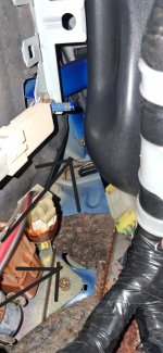

Had a good look and feel around and the fabric behind the loom on the right is wet and right up in the corner where the dash meets the bottom of the windscreen is wet aswell...see pics..
The loom feels damp in parts aswell and behind the pedals, would the sealant around the screen be gone somewhere? Does it happen? Do I need to pull the trim and wipers etc for a look around?
Did it ever get a windscreen?
Mine was gone in the 4 corners because of a bad fitting screen in 2011 , only found it 2024
Dried the carpet and fabric with a heat gun and stuffed a microfiber cloth up into the corner for the mean time..might run a hose and see does the cloth get wet
