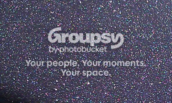

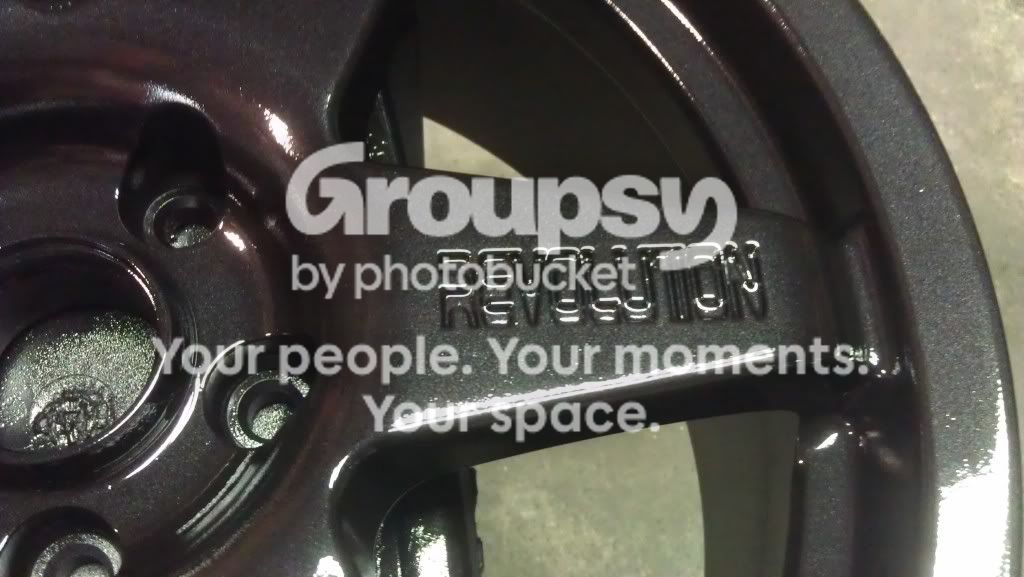

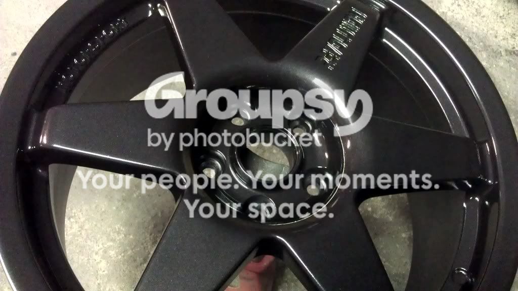

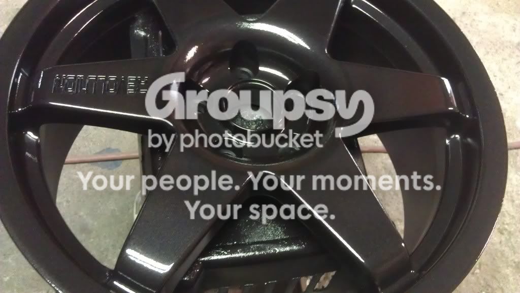

Got the finish coat done on the wheels today, brought them out into the sun to see what the fleck is like and to get a pic,
cant wait to get the lacquer on :smile:

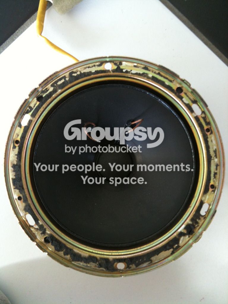

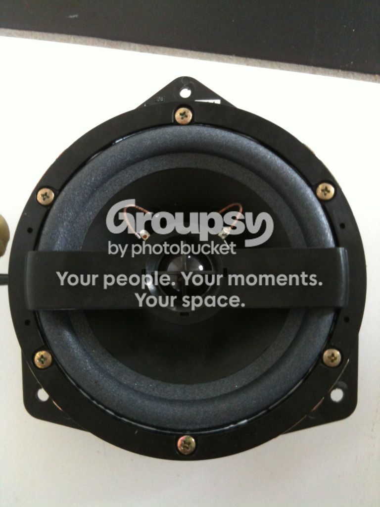

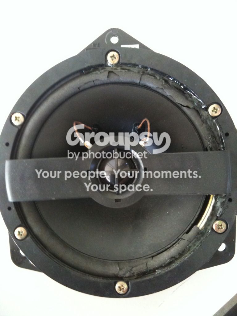

Didi a bit of work sorting out the stereo on the car. Speakers were buzzing coz the foam surrounds were in bits. Pretty much impossible to get replacement speakers due to the McIntosh speakers being 8ohm and nearly every other speaker i looked at was 4 ohm so went on ebay and got a refoam kit.
Here's how they looked
During
And the finished product!

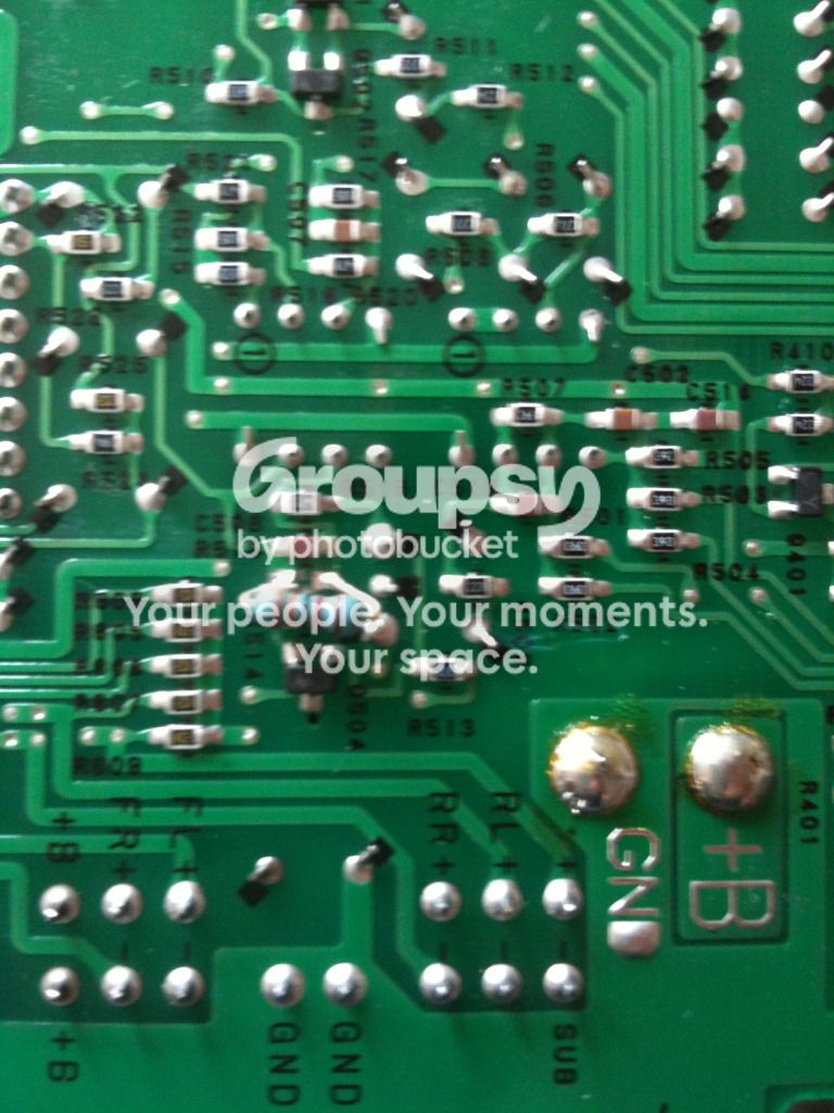

Also took apart the amplifier and soldered in a higher value resistor on the circuit controlling the output for the sub in the boot.
Pic isnt great coz had to get close up with the iphone
There's a lovely thump from the sub now without having to crank the bass on the head unit

[quote author=Nic Spec C link=topic=30408.msg394050#msg394050 date=1336682703]

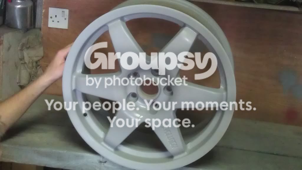

Started to give the milleniums a freshin up, settled on black with a silver and blue fleck (Black toledo being its offical name),
primed and 1 coat on today, will get finish coat on tomorrow and then 4-5 coats of "good lacquer" on this set of rims :thumbsup:
wheels look amazing nick
