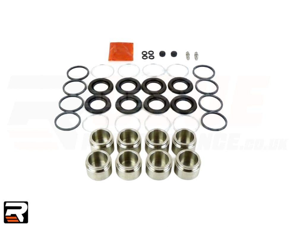

Hi Lads,
By any chance would anyone have Impreza WRX two pot calipers in any condition? Badly stuck for the rubber grommets that seal the two halves of the caliper together, alternatively if anyone has these seals.
Thanks
Only some kits come with them, as above ICP dont ship them. Subarak is in Poland so no customs, you'll be a few days waiting for them. Sameish shipping time from them as UK i found
I replaced mine with just a normal same sized o ring when I was doing them, it is just an o ring at the end of the day. Doesnt have to be subaru 4 pot specific as long as its the same size and okay to use with brake fluid
Ali Burrow usually has good stock of seals, but you'd have to ring him if you want them asap. Hes quick on messenger sometimes
