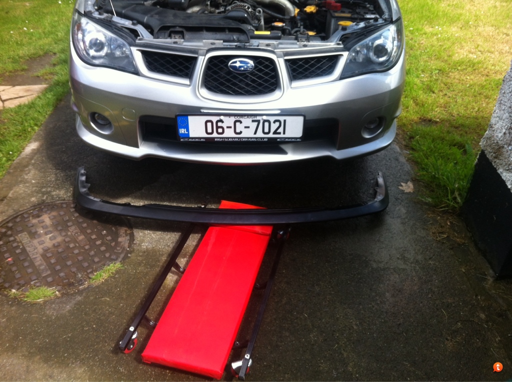

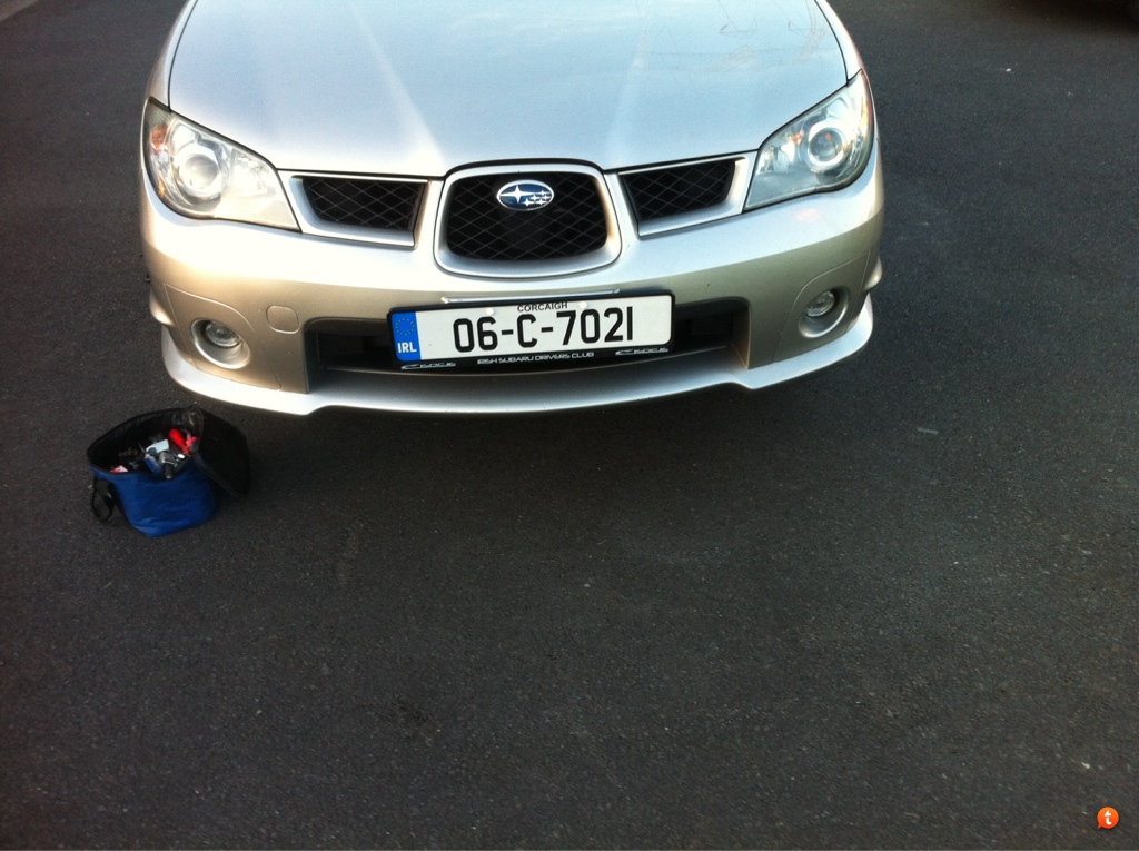

Fitted splitter. Colm was on hangover but helped me (more I helped him, fair play).
Unfortunately my camera died so have Pics on my mobile (my main one went for repair so I am using old iphone 4, quality is far from good).
Before:
In middle of preparation:
And after, two Pics:
[quote author=p1impreza link=topic=30408.msg479833#msg479833 date=1402245138]
Makes the front more purposeful now,
Just mind it when parking
and speed ramps
and multistory car park ramps
and anything else bigger than a catseye on the road
looks great

TBH it is not too bad.
Suspension is not lowered yet so had no problems yet on my usual way.

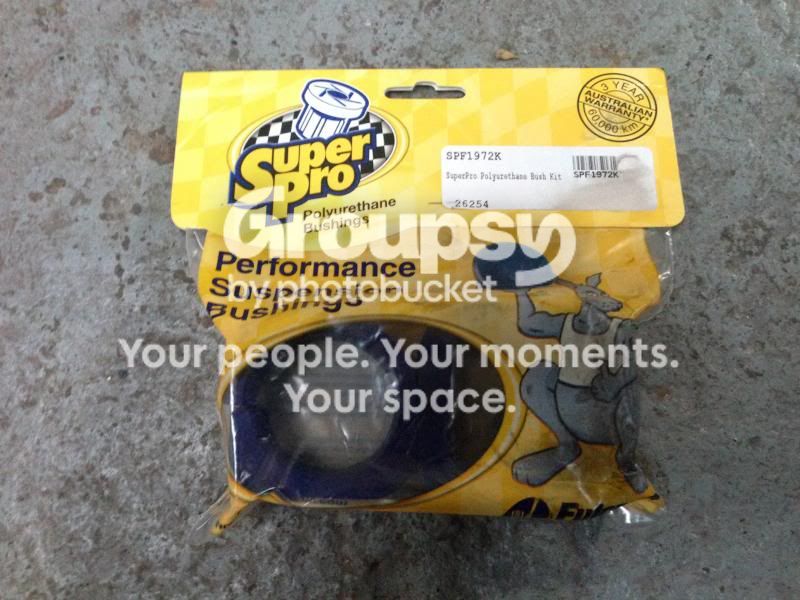

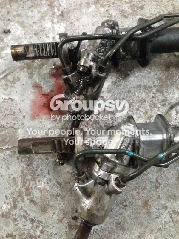

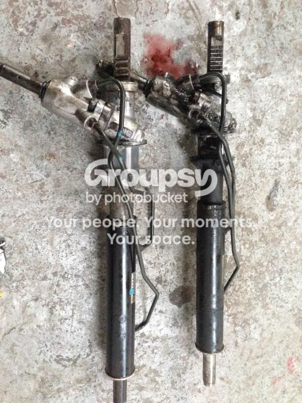

Finally fitted the quick rack from TypeRA limited
Here's a difference (at the top is the standard type-R STi fast rack 15:1, at the bottom the quick rack 13:1) look at the notches! :)
Took me about 2 hours to replace it so not too bad :)
I mounted it on the new SuperPro polybushes.
btw. if someone is looking for one, the part number for the original STi Type-RA ltd quick rack is 34110FA092 :thumbsup:
