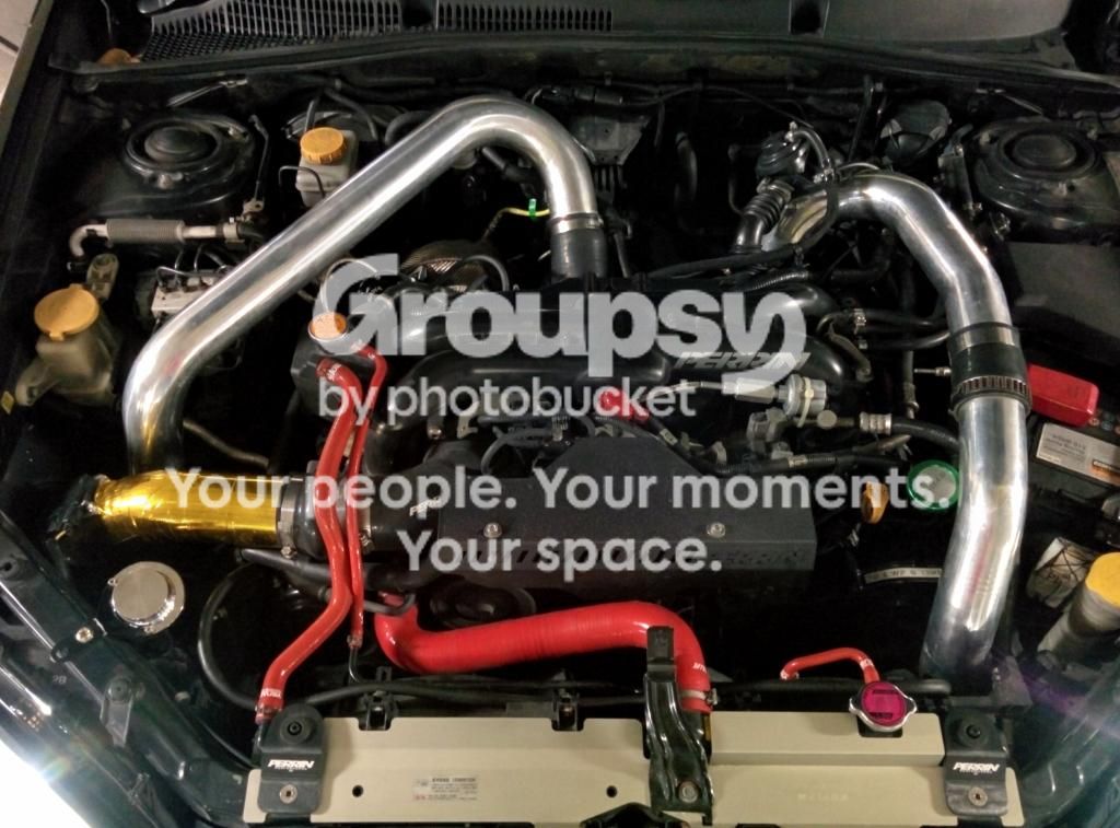

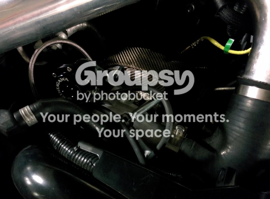

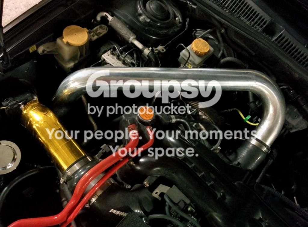

new turbo, new headers and up pipe, DEI turbo blanket, new coolant, new oil and filter, new gaskets all round, and some other jiggery by Ciaran to make it all fit nicely together, he some man for attention to detail and not giving you the car back until he is 100% happy with the work done. A few more things needed to be done before i can get it remapped :)
Red silicone pipes add 30bhp

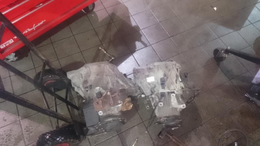

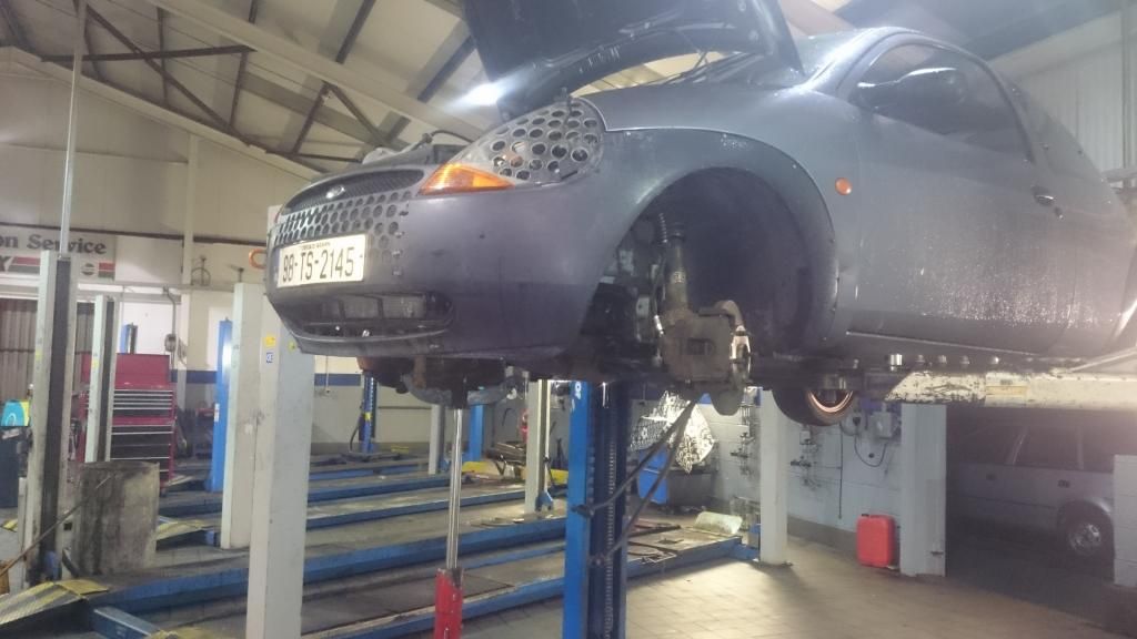

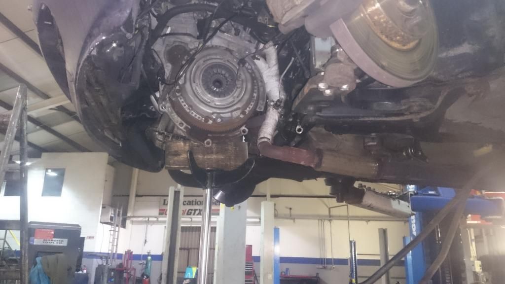

well after the trackday and doing 153 miles on track and ending the day with battling a 106gti driven by Ciaranrsra ,I killed ny gearbox in the ka so I got it into the workshop this eve and stripped it down in preparation to fit a gearbox from a ford focus 1.6 petrol this will allow me to fit the gearshift and cables from the focus thus making the ka cable shift instead of shaft shift I can then rise the gearshift up off the floor making it easier to select gear while im at it ill make a short shifter
the puma box is the one on the right the focus is on the left its a slightly bigger box and has stronger gears so should help

Very tidy, whens mapping ?
Waiting on new intercooler to arrive, and need to get proper injectors and get a better downpipe to cat back section sorted as Ciaran said its a 3" downpipe to a 2.5" lower center cat with no tapering so its a big restriction. Not a big job but need to get the correct layout for best flow
