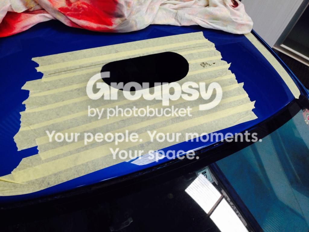

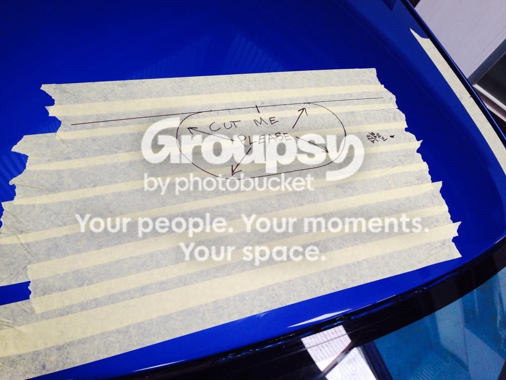

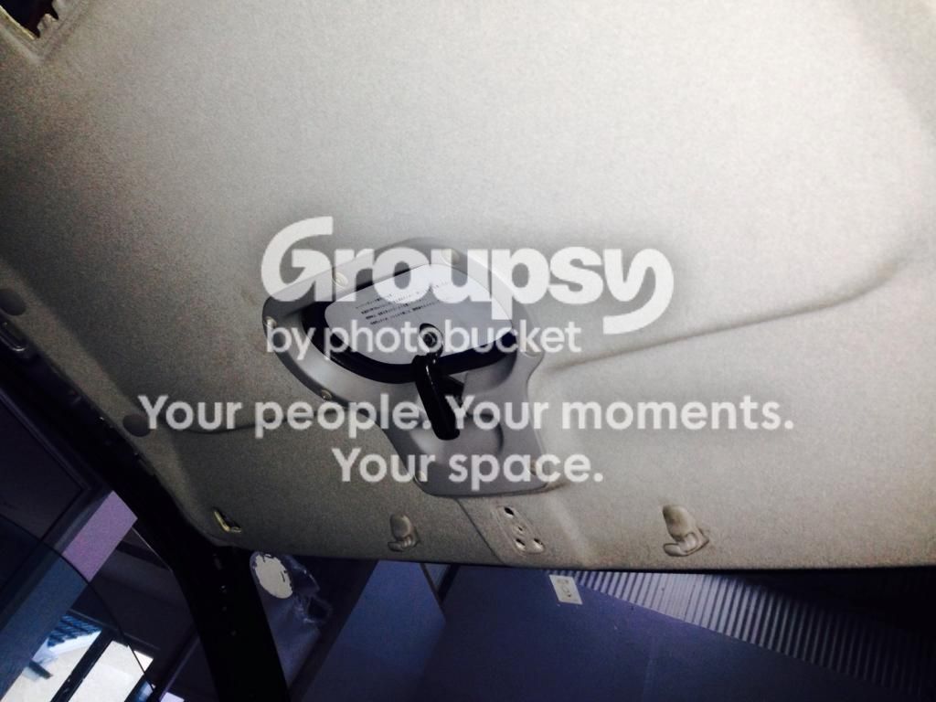

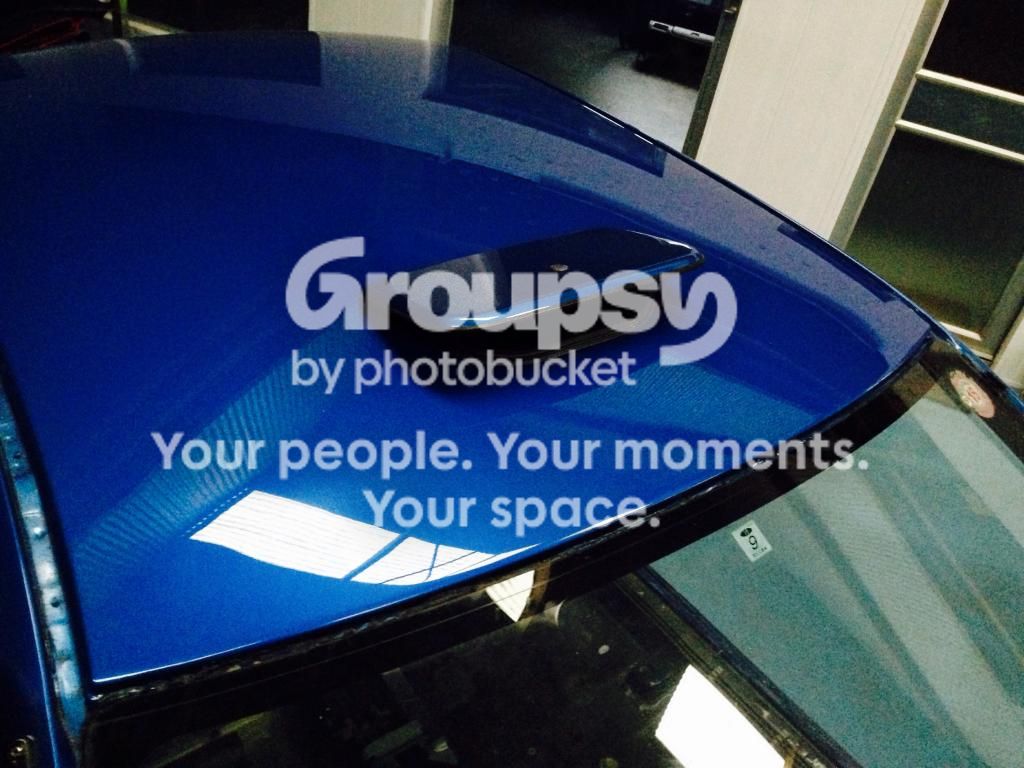

[quote author=keith dublin link=topic=30408.msg499355#msg499355 date=1418426021]
Balls of steel man fair play any more pics of the car

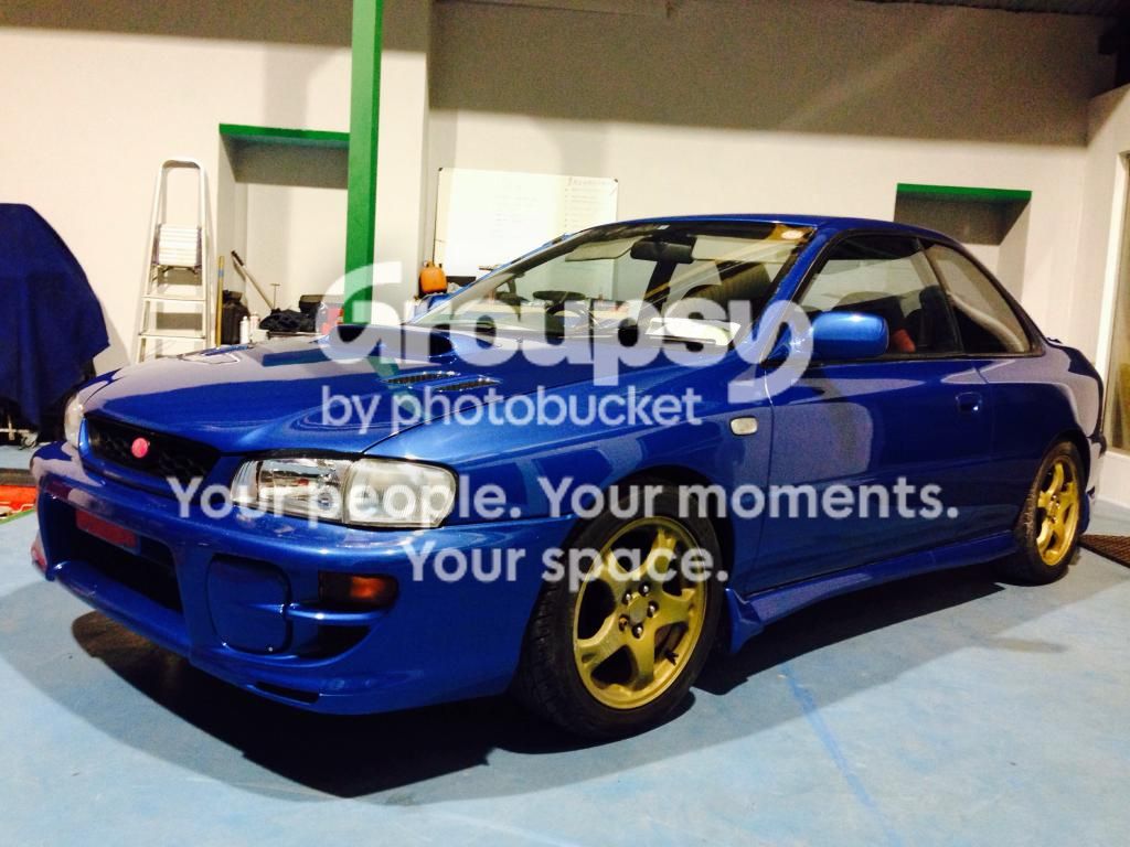

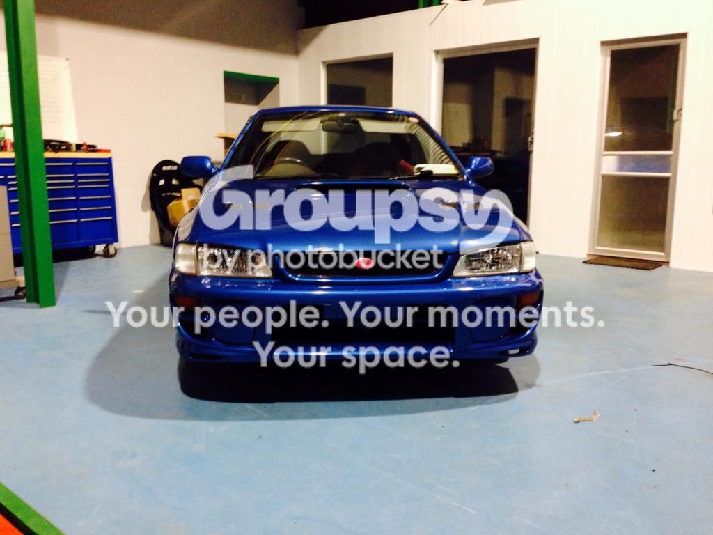

Ha ha cheers lad. A bit scary cutting a big hole in the roof alrite. These are the only 2 I have at the minute, wheels are only temporary, have a set of st2's in 17's fully refurb to go on and rear spoiler is also yet to be fitted. Heading back to get the engine bay painted tomorrow so she's fully stripped ready to go
[quote author=keith dublin link=topic=30408.msg499367#msg499367 date=1418427264]
Wow looks savage man who did the paint for you
It was a polish lad down here in fermoy co. Cork, Bart is him. It looks better in person and to be fare, wasn't that hard to pay
[quote author=Rob Spec C link=topic=30408.msg499434#msg499434 date=1418477600]
Pics look like glass paint, was it done a proper job windows out?
Ya proper job windows out, main reason was the clips that hold on the trim around the front and rear screens nearly all break removing the trim, so you must remove windows, clean off all the old window sealer, put new clips on, then put on the new sealer and reinsert the screens. The trims could probably be put back on without the windows being removed but would be very hard to get them right, and I'm very particular so had to be right

Excellent, delighted to hear it was done right, you see some jobs and they look great from 10ft until you walk around the car and see all the masking marks :cuckoo:
Hopefully see it at something next year :thumbsup:

x2
Is there any crowd that do this.
I'd love a roof vent. I know they serve no purpose but it would be cool to have one
