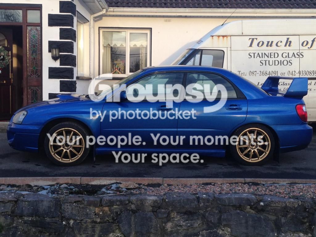

hi guys hope ye all had a great xmas, well this eve i said id do a few bits with the car since i havent touched a thing on it since i got it 3 weeks ago, first up was put on the 17" rotas i picked up yesterday, the not the 18" i wanted but they will do for now,

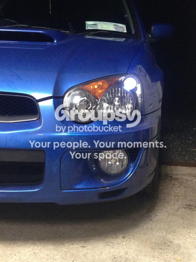

then i headed for the warmer garage, first up was the parking bulbs , omg what a bitch to do sweet lord above had to take out headlights to get new led bulbs in, is this normal guys ? have to say they look well

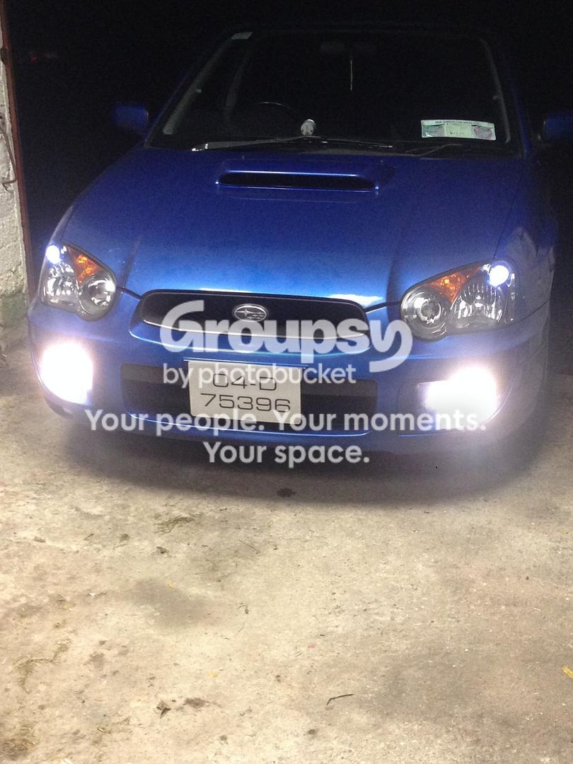

next up was the fog light bulbs both were blown another pain in the ass not as handy as the old classics to do, noticed the drivers side lense has small hole in it so will be looking for a new one soon but not to worried as im going to get the sti covers ,

nice car , and yes bulbs are a pig to change , fog lights are fine once ya figure it out , but bulb in the headlight are just awkward to get at .
They are a pig but I found if you spanner off the top mounting bolts on headlight then pop out grill you can see a white locating bracket ratchet this off and headlight out in 3 mins easy peasy[emoji4]
